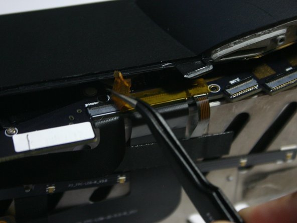

Remove other ribbon cables
  • Remove the kapton tape from the ribbon cable connectors.
  • Disconnect the lightbar, display, and lighthouse ribbon connectors which the tape covered, and disconnect the top and bottom USB-C port ribbon cables.
  • If you don't want to open the eye tube, you dont need to disconnect the lightbar or display ribbon cables.
  • Carefully peel up the top and bottom USB-C ribbon cable ribbons from the metal display support, as they are glued on.
  • On reassembly, carefully make sure the ribbon cables are fully seated. These cables are double-row. If the white line isn't up against the edge of the connector, the contacts could make connection with the wrong pins.
