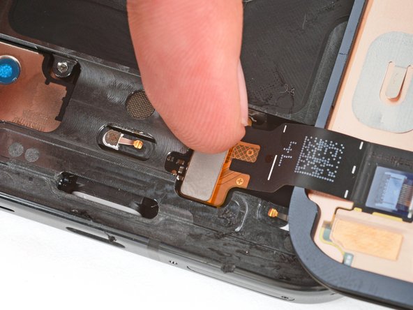

  • Be very careful not to strain the screen cable during this step. You may need to hold the screen up at an angle to help position the cable.
  • Align the screen press connector over its socket and gently press down on one side until it clicks into place, then press down on the other side.
  • Don't press down in the middle. If the connector is misaligned, the pins can bend and cause permanent damage.
  • Now is a good time to test your phone before sealing it up. Power it on and check that it works. Power it back down before you continue reassembly.
  • Hook the bottom edge of the screen cable bracket into its cutout and firmly press down on the top edge until the bracket clicks into place.
