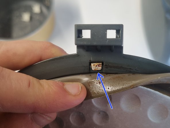

Dismantling inner lid
  • To remove the ABS plastic clips I had to use a nail/thin screwdriver to push the clip ends inside the housing
  • Aluminium plate (like other parts of this cooker) held on by crimped tabs - had to uncrimp them using a thin screwdriver
