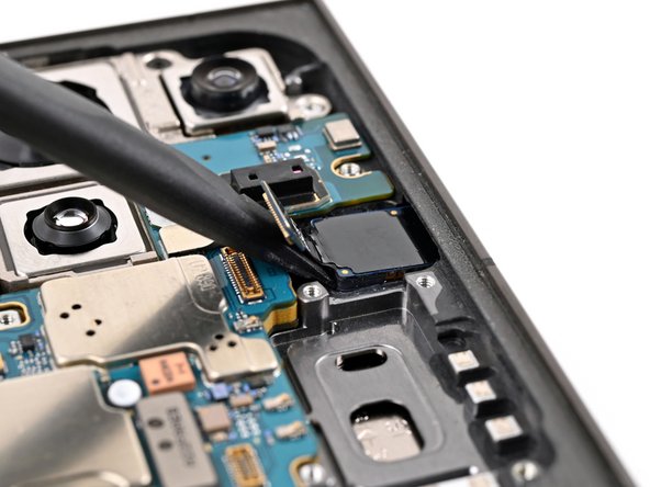

Pry up the front camera
  • The adhesive securing the camera is very strong. Work slowly and apply more heat if the front camera feels stuck. Avoid separating the sensor from the lens, such as this.
  • Use the flat end of a spudger to pry the front camera from its recess in the frame.
  • If the camera doesn't loosen, use a SIM eject tool to scrape away the epoxy surrounding the camera.
