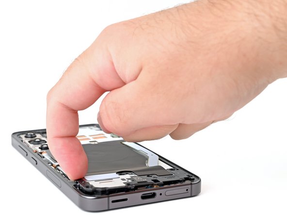

  • Use your fingernail or the flat end of a spudger to pry up the wireless charging coil and loudspeaker assembly away from the frame.
  • Remove the wireless charging coil and loudspeaker from your phone.
  • During reassembly, press around the edges of the loudspeaker to clip it to the frame before reinserting the screws.
