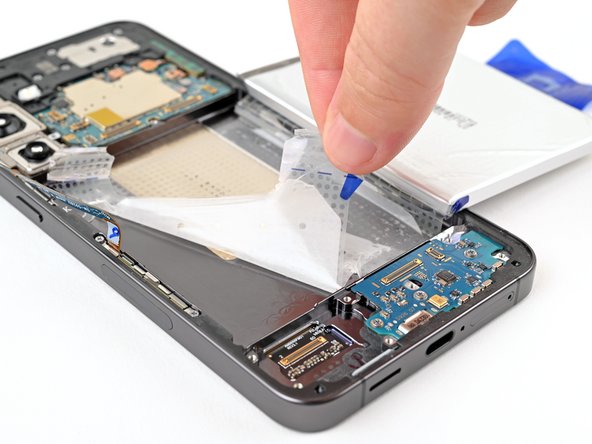

Remove the battery
  • Peel up the remaining film from the frame.
  • Remove the battery.
  • If you used isopropyl alcohol, wait ten minutes before installing the new battery to allow the alcohol to completely evaporate.
