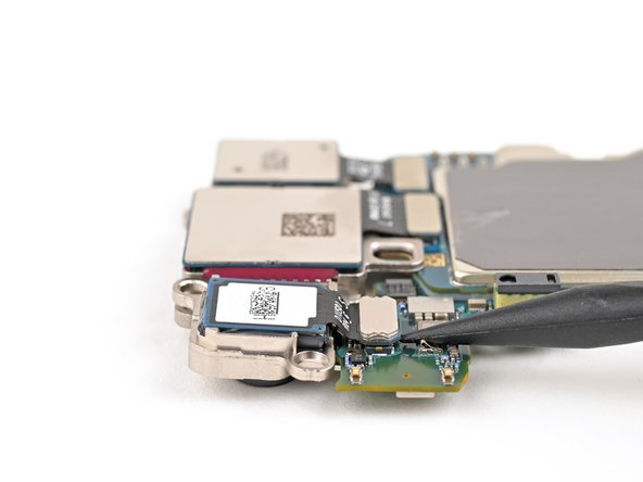

Disconnect the ultrawide camera
  • Insert the point of a spudger underneath the ultrawide camera press connector and pry up to disconnect it.
