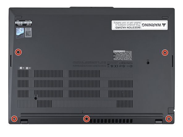

Loosen the base cover screws
  • Use a Phillips screwdriver to fully loosen the five remaining captive screws securing the base cover.
