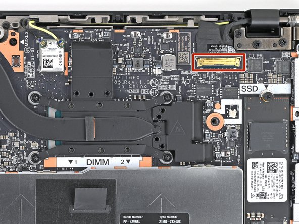

Lenovo ThinkPad T16 Gen 3 Motherboard Replacement, Disconnect display cable: crwdns2935265:00crwdnd2935265:01crwdnd2935265:03crwdne2935265:0 Lenovo ThinkPad T16 Gen 3 Motherboard Replacement, Disconnect display cable: crwdns2935265:00crwdnd2935265:02crwdnd2935265:03crwdne2935265:0 Lenovo ThinkPad T16 Gen 3 Motherboard Replacement, Disconnect display cable: crwdns2935265:00crwdnd2935265:03crwdnd2935265:03crwdne2935265:0
  • Use a clean fingernail or the flat end of a spudger to gently push under and lift the metal buckle of the display cable connector to unclip it.
