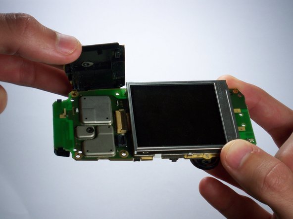

  • Carefully detach the keypad board from the phone.
  • There is no need to unlatch the opposite side, it will come loose freely. Just be careful to snap back on both sides when you put on the new keyboard.
  • Watch out the plastic cap on the bottom of the phone fall loose at this point. Just don't loose it or forget to re-assemble.
