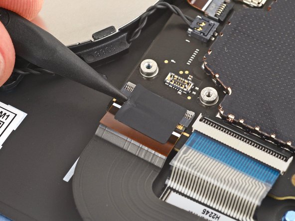

Disconnect the trackpad cable
  • Gently slide the point of a spudger under the piece of tape on the trackpad cable ZIF connector, near the bottom left corner of the motherboard.
  • Use the spudger to lift the tape from the connector.
  • You don't need to fully remove the tape, it just needs to be off the connector.
