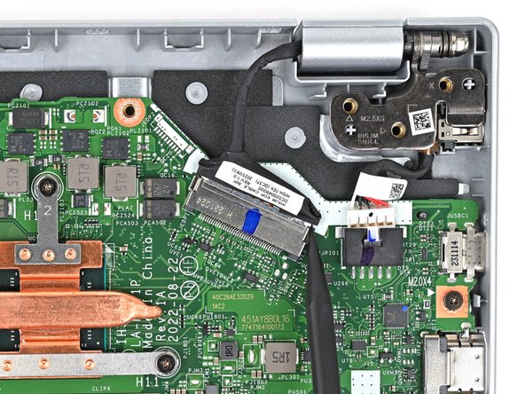

Disconnect the display assembly
  • Use the tip of a spudger to push down on either side of the display cable connector until it comes out of its socket.
