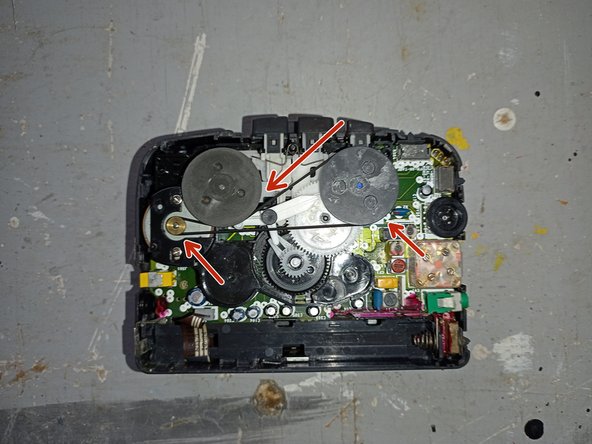

Sony WM-FX123 Belt Replacement, Install the new belt: crwdns2935265:00crwdnd2935265:01crwdnd2935265:01crwdne2935265:0
  • Install the new belt around the wheels as pictured. Try to avoid twisting the belt as you install it or you may have issues later.
