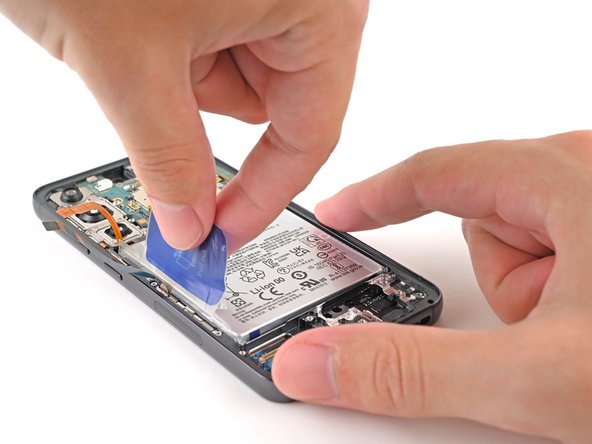

Separate the battery adhesive
  • With one hand, fold the two upper and lower tabs out of the way of the battery and firmly hold down the frame.
  • If you're having trouble with the tabs, you can fold them under the phone and tape them to the screen.
  • With your free hand, grip the blue center pull tab and pull straight up with strong, steady force to separate the battery adhesive.
  • The adhesive might not separate immediately. Keep pulling with consistent force until the battery comes free from the frame.
  • If you're having trouble, apply 1-2 drops of high-concentration (more than 90%) isopropyl alcohol to the left edge of the battery. Elevate the left edge of your phone and wait one minute for the alcohol to soften the adhesive.
  • Lay the battery over the right edge of your phone.
