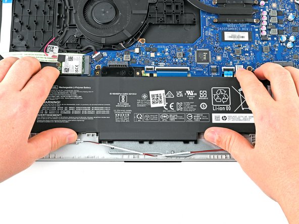

Remove the battery
  • Do not grab the battery at the ends because this battery is flexible. Instead, grab the battery one inch from each end to better support the middle.
  • Use two hands to grip the battery about one inch from each end.
  • Lift the front of the battery (the side closest to you) until the battery is free of its alignment pegs.
  • Pull the battery towards you to release it from its connector.
  • Don't continue to use a damaged battery, as doing so is a potential safety hazard. If in doubt, replace it with a new battery.
  • During reassembly, insert the battery onto its connector at a slight downward angle before pressing it flat to the frame.
