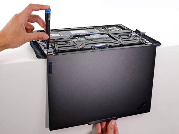

Remove the screen
  • Keep a firm grip on your laptop, as it can easily fall off the table.
  • Support the screen with one hand and use your free hand to remove the four 4.4 mm–long Phillips screws securing the hinges.
