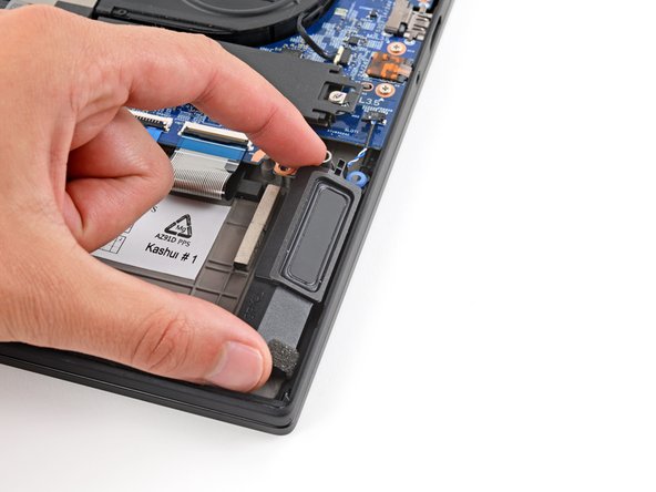

  • Use your fingers to lift the speaker off its posts and remove it.
  • During reassembly, put the two grommets over their posts and push the speaker down so it slides into place.
  • Only press on the rigid plastic at the bottom and edges of the speaker. Pushing in the center near the soft diaphragm may damage the speaker.
