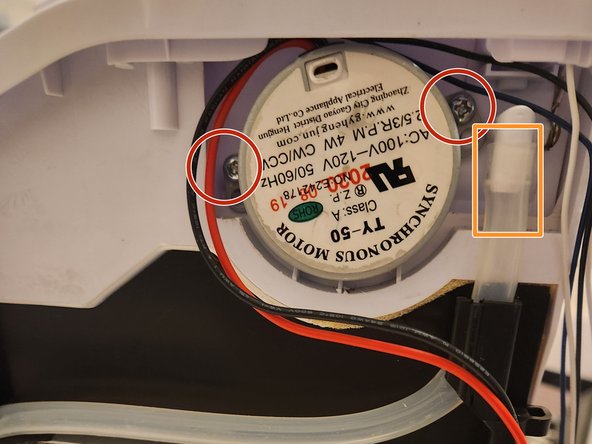

ikich Countertop Ice Maker Teardown, remove tray motor and water intake: crwdns2935265:00crwdnd2935265:01crwdnd2935265:01crwdne2935265:0
  • remove two screws holding the tray motor in place. Then pull the tray motor straight out. It may require a bit of force if rust is sticking it onto the tray
  • remove the water intake hose by pulling it straight down
