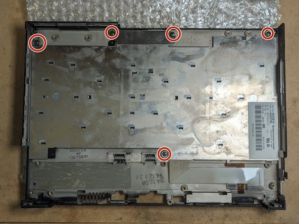

  • Remove the five screws from the keyboard and the trackpoint button stiffener plate.
  • Stiffener plate and upper right corner: three 4mm black screws
  • Upper left: 5mm silver screw
  • Lower center: 3mm black screw
  • Remove the trackpoint button stiffener plate
  • Remove the keyboard.
