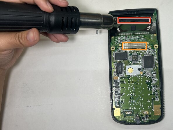

  • Set your heat gun to the lowest setting(around 150 degrees)
  • If you are missing lines on the screen, aim at the top ribbon cables and heat the cable evenly for about 5 seconds.
  • Then heat and apply pressure using the plastic opening tool for about 5-10 seconds, applying pressure to different sections of the ribbon cable within that timeframe.
  • Continue to apply pressure throughout the ribbons.
  • If the screen is Glitchy, do the same for the bottom ribbon cable.
