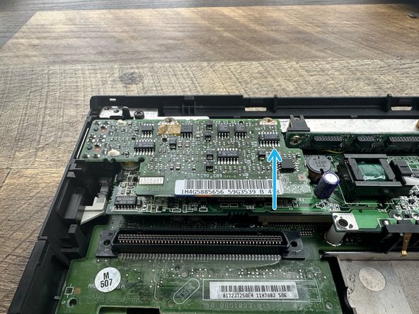

Remove Audio and Power Boards
  • Remove the Audio Board from the connector by lifting it up from the right, then pulling straight up and out.
  • Remove the top single (1) M2.5x4mm Philips screw from the top along with the metal bracer.
  • Remove the single (1) M2.5x7mm countersunk Philips screw from the power jack.
  • Remove the Power Board from the connector by lifting up from the right, then pulling straight up and out.
