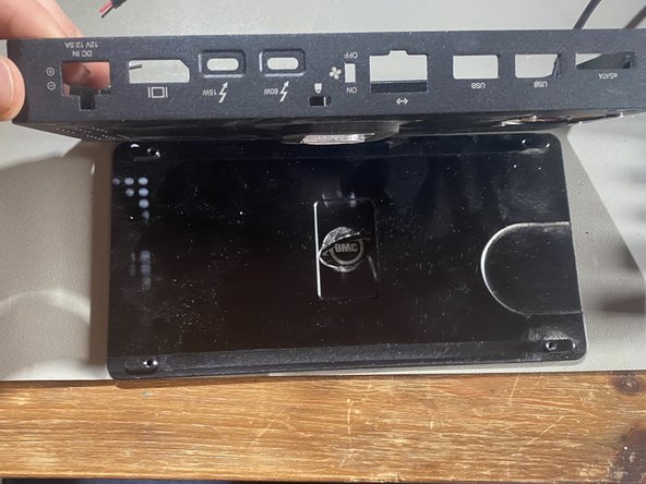

Re-installing the top lid
  • Line up the top lid with the main chassis, make sure to have the fan vent in the correct orientation so it can breathe.
  • Screw the lid back in with the four TORX TR8 screws
