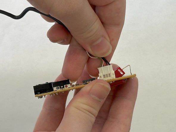

  • Pull the USB cable away from the connector in the same direction as the individual wires to remove it from the motherboard.
  • This step may prove difficult with just your hands. Use a spudger if you need to.
  • Pull evenly on the full width of the cable so that no individual wires are overly strained.
