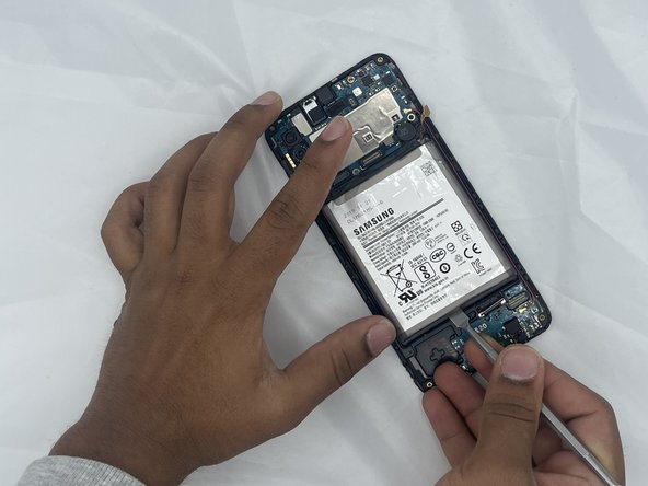

  • Apply a couple of drops of high-concentration isopropyl alcohol at the top of the battery to help loosen the adhesive that secures it.
  • Use an opening pick to gently pry up the battery.
  • Take care not to bend or puncture the battery.
  • Remove the battery.
  • During reassembly, if your new battery doesn't come with pre-applied adhesive, apply some to the well. Then, firmly press the new battery into place.
