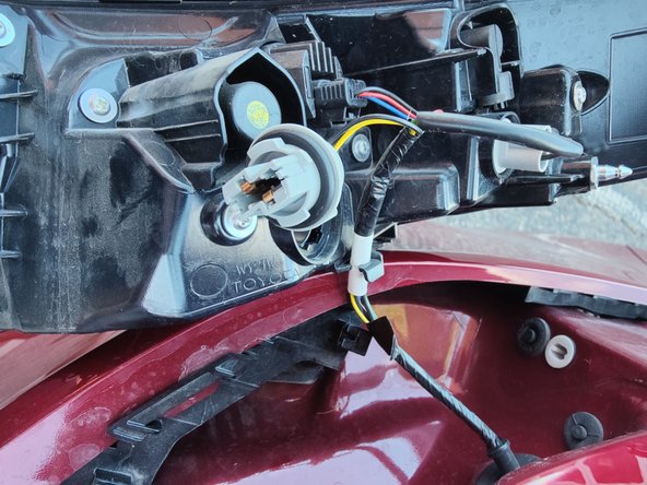

2018-Present Toyota Corolla Tail Light Bulb Replacement
crwdns2935425:06crwdne2935425:0
crwdns2931653:06crwdne2931653:0
2018-Present Toyota Corolla Tail Light Bulb Replacement: crwdns2935265:00crwdnd2935265:01crwdnd2935265:01crwdne2935265:0
  • Remove the non-functioning light bulb by pulling it from the bulb socket.
  • Bulb is held in place by retention clips and may require gently working the bulb back and forth while pulling.
  • Insert the replacement bulb into the socket.
