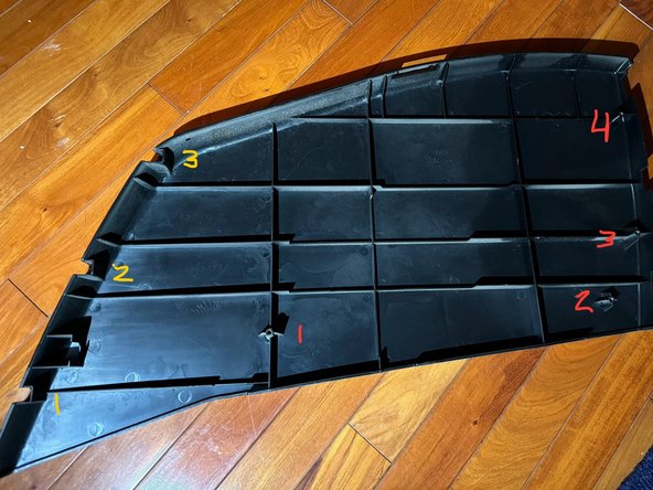

Removing the lower side panels part 2
  • there are four #2 Phillips screws to be removed along the front and top of the panel shown in red numbers on the first photo
  • The second photos shows how the top center screw can be Gard to get to
  • all of these screws are accessed from the inside of the arm rest. Near where the outsides of where your thighs would be if you were sitting in the chair
