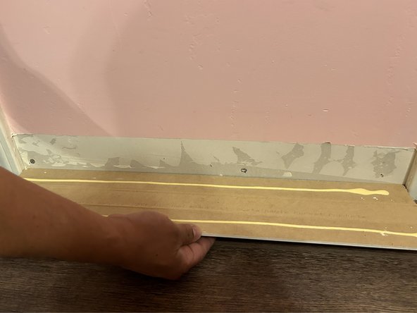

  • Align the baseboard with the wall. Press and hold the side of the baseboard with the glue against the area that the baseboard will cover.
  • More glue can be added if there are any loose areas.
