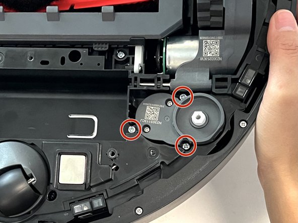

  • Remove the three 10 mm Phillips screws that secure the side brush motor.
  • Gently lift the side brush motor up and out of its housing.
