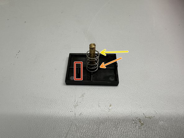

Replacement: Configuring The New Button
  • Locate your replacement button and place it such that the black plastic post is closest to you.
  • Keeping the button in this orientation for the remainder of the repair will ensure the correct orientation upon completion.
  • Slide the black felt washer down to the base of the shaft.
  • Position the spring around the shaft in-between the small plastic posts.
