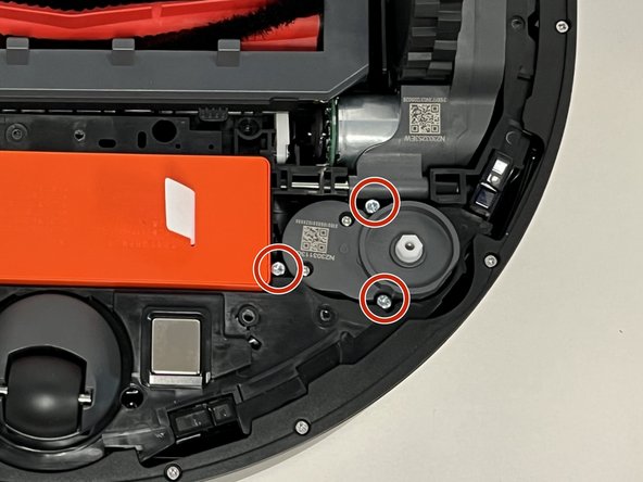

  • Use a Phillips screwdriver to remove the three 10 mm Phillips screws that secure the side brush motor.
  • Carefully lift the side brush motor up and out of its housing.
