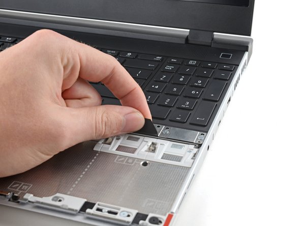

Remove the numpad
  • The numpad is held in place with strong magnets. Apply gradually increasing force to avoid having the numpad violently eject.
  • Grip the pull tab at the bottom of the numpad.
  • Lift the pull tab until the numpad magnets release.
  • Remove the numpad.
  • During reassembly, make sure the numpad is seated properly on its alignment pegs and sits flush with the edges of the laptop.
