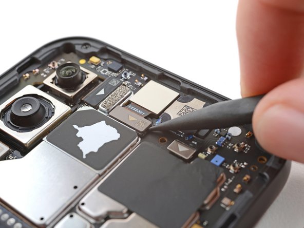

Fairphone 5 Front Camera Replacement, Remove the front camera: crwdns2935265:00crwdnd2935265:01crwdnd2935265:03crwdne2935265:0 Fairphone 5 Front Camera Replacement, Remove the front camera: crwdns2935265:00crwdnd2935265:02crwdnd2935265:03crwdne2935265:0 Fairphone 5 Front Camera Replacement, Remove the front camera: crwdns2935265:00crwdnd2935265:03crwdnd2935265:03crwdne2935265:0
  • Use the tip of a spudger to pry up and disconnect the front camera press connector.
  • Lift the front camera out of its slot in the frame and remove it.
