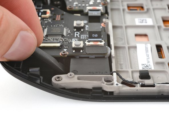

Pry up the right speaker
  • Be careful not to damage the speaker mesh underneath the speaker.
  • Insert the flat end of your spudger between the right speaker and the frame.
  • Slowly pry up the speaker to separate the adhesive securing it.
  • If the speaker feels stubborn, lightly heat it using a hair dryer.
  • During reassembly, make sure that the speaker mesh lays flat against the frame before installing your new speakers.
