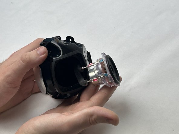

  • Using a Torx T5 bit, remove the four 1cm screws around the speaker and slide it out of the housing.
  • Pull 2 speaker cables off of the speaker and detach it.
