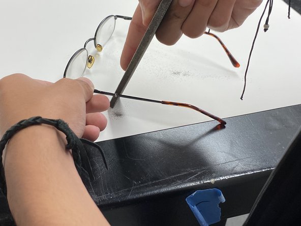

  • Press a file or thin blade against the solder in order to remove the excess hardened solder.
  • File against the solder for grains of the solder to fall off the glasses.
  • Don't remove too much solder as that will compromise the integrity of the connection.
