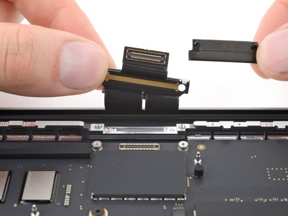

Screen cable reassembly information
  • During reassembly:
  • Insert the cable buffer into the metal bracket with the buffer's alignment pegs pointing toward the MacBook and closest to the cable's press connector.
  • Align the cable buffer's pegs with its holes in the frame.
  • Press the cable bracket onto the frame, so its metal tabs clip into place.
