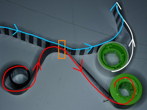

Printing Process
  • The clear top tape (light blue line) is usually completely clear.
  • The tape is empty and the zebra stripes indicates it to the user.
  • The thermal ink tape gets unrolled and again rolled onto another roller.
  • In the printing zone, a single column of heat "pixels" heats the thermal ink (red line) and sticks it to the clear top tape (blue line).
  • The clear top tape than gets laminated with the white backing (white line).
