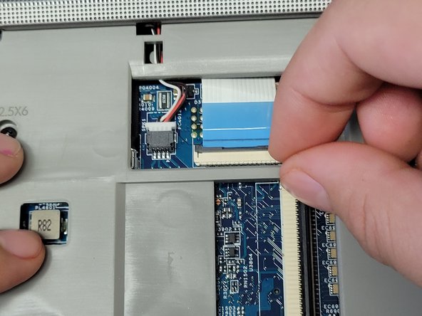

  • Disconnect the power button board cable by lifting the connector latch.
  • Using the blue tab, disconnect the cable from the system board.
