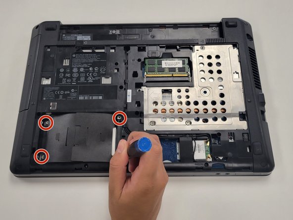

  • Remove the four 4.0 mm Phillips PM2.0×4.0 screws that secure the hard drive to the computer.
  • Slide the hard drive to the left and lift it away from the computer.
