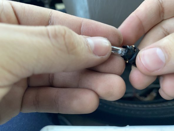

  • Grab a new 74 fluorescent light bulb and push back into the housing.
  • If you decide to replace the light bulbs with LED bulbs instead of fluorescent then you will have to test the connection by plugging in the connections and turning the key to the run position.
  • LED bulbs only function if they are in a certain orientation so just pull out the housing turn 180 degrees and test it again.
