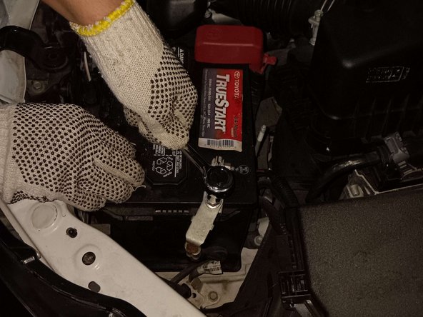

  • Disconnect the connector on the right with no coloring or cap.
  • Remove the vertically facing screw to disconnect the battery.
  • Loosen the clamp on the side directly connected to the battery.
  • Move both away from the battery once they've been disconnected/loosened enough to disconnect.
