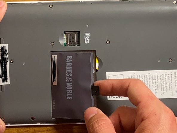

Install New Battery
  • To install the new battery, please place it bottom first, in the battery compartment. This is because the battery has plastic tabs that will not insert any other way.
  • Next, retrieve your Phillips #0 Screwdriver one more time, and install the screw in its original position.
  • Congratulations, you have successfully replaced a "Nook (1st Generation)" battery.
