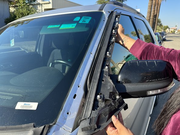

2011-Present Ford Explorer Driver Side Front Pillar Trim Replacement
2011-Present Ford Explorer Driver Side Front Pillar Trim Replacement: crwdns2935265:00crwdnd2935265:01crwdnd2935265:02crwdne2935265:0 2011-Present Ford Explorer Driver Side Front Pillar Trim Replacement: crwdns2935265:00crwdnd2935265:02crwdnd2935265:02crwdne2935265:0
  • Remove the damaged interior pillar trim and clean surrounding areas.
  • Use a rag and glass cleaner to clean the pillar trim area.
  • Avoid contact with skin, eyes and clothing. Wash thoroughly after handling.
  • Remove any remaining residue from the window and metal. Use as much window cleaner as necessary.
