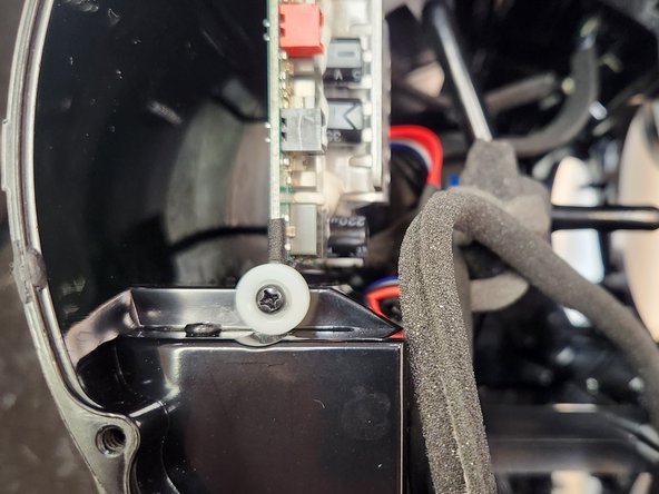

JBL Boombox Motherboard Replacement, Unscrew the Motherboard Sides: crwdns2935265:00crwdnd2935265:01crwdnd2935265:02crwdne2935265:0 JBL Boombox Motherboard Replacement, Unscrew the Motherboard Sides: crwdns2935265:00crwdnd2935265:02crwdnd2935265:02crwdne2935265:0
  • On either side of the motherboard on the bottom, there is a single screw with a large white plastic washer.
  • Using your Phillips #2 Screwdriver, remove both of these screws.
  • Keep these screws separate, as they do not match screws used in other steps.
