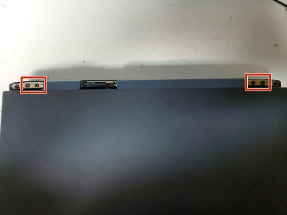

Removing the Display Assembly
  • Remove the four screws securing the display assembly hinges to the palmrest.
  • Carefully and slowly open the laptop, and then disconnect the two cables connecting the display assembly to the motherboard.
  • One of the cables (the LCD data cable) is connected to an interposer board which is secured by a screw. To remove the other cable (the inverter cable), disconnect the interposer board first.
  • Lift the display assembly from the base of the laptop.
