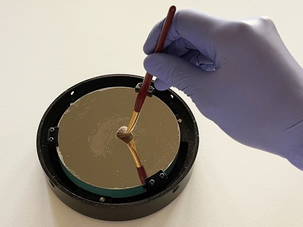

  • Lay the back panel flat on a table with the mirror facing upwards and grab a camel hair brush.
  • To remove dust particles, lightly brush the mirror's surface starting in the center and pulling out towards the edge of the mirror.
  • Perform center to edge strokes 360 degrees around the mirror.
