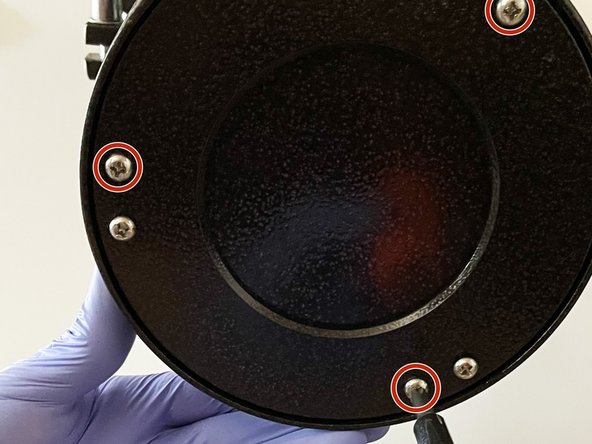

  • Locate the back of your telescope and notice the 3 pairs of screws with one screw sticking further out than the other in each pair.
  • Remove the three 19.1 mm lower resting screws from your telescope using a Phillips #1 screwdriver.
  • While unfastening the 3rd screw, palm the back panel of your telescope so it doesn't fall off unexpectedly.
  • Carefully pull back the loose panel exposing the primary mirror and set it aside.
