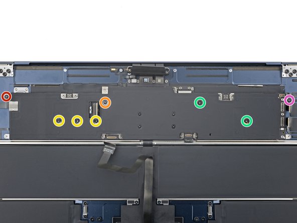

Unfasten the logic board
  • Use a 3IP Torx Plus screwdriver to remove the two screws on the upper left edge of the logic board:
  • One 2.6 mm‑long screw
  • One 4.7 mm‑long screw
  • Use a 5IP Torx Plus screwdriver to remove the six remaining screws securing the logic board:
  • Three 3.1 mm‑long screws
  • Two 3.8 mm‑long screws
  • One 3.6 mm‑long screw
