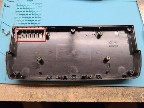

Trouble Spot
  • The board connects to the main unit through springy contacts embedded in the lower display base.
  • If these spring contacts or the spot on the board they rest against are corroded as on this unit, the braille display may not function correctly.
  • Cleaning these with emery cloth, steel wool, or a pencil eraser will get them shiny again.
