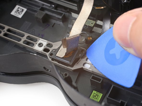

Remove the pass-through camera
  • The pass-through camera is lightly adhered to the camera array.
  • Insert an opening pick under the corner of the pass-through camera, near the screw hole.
  • Slide the opening pick forward and pry upward to separate the adhesive.
  • Lift the pass-through camera off its two alignment pegs and remove it.
